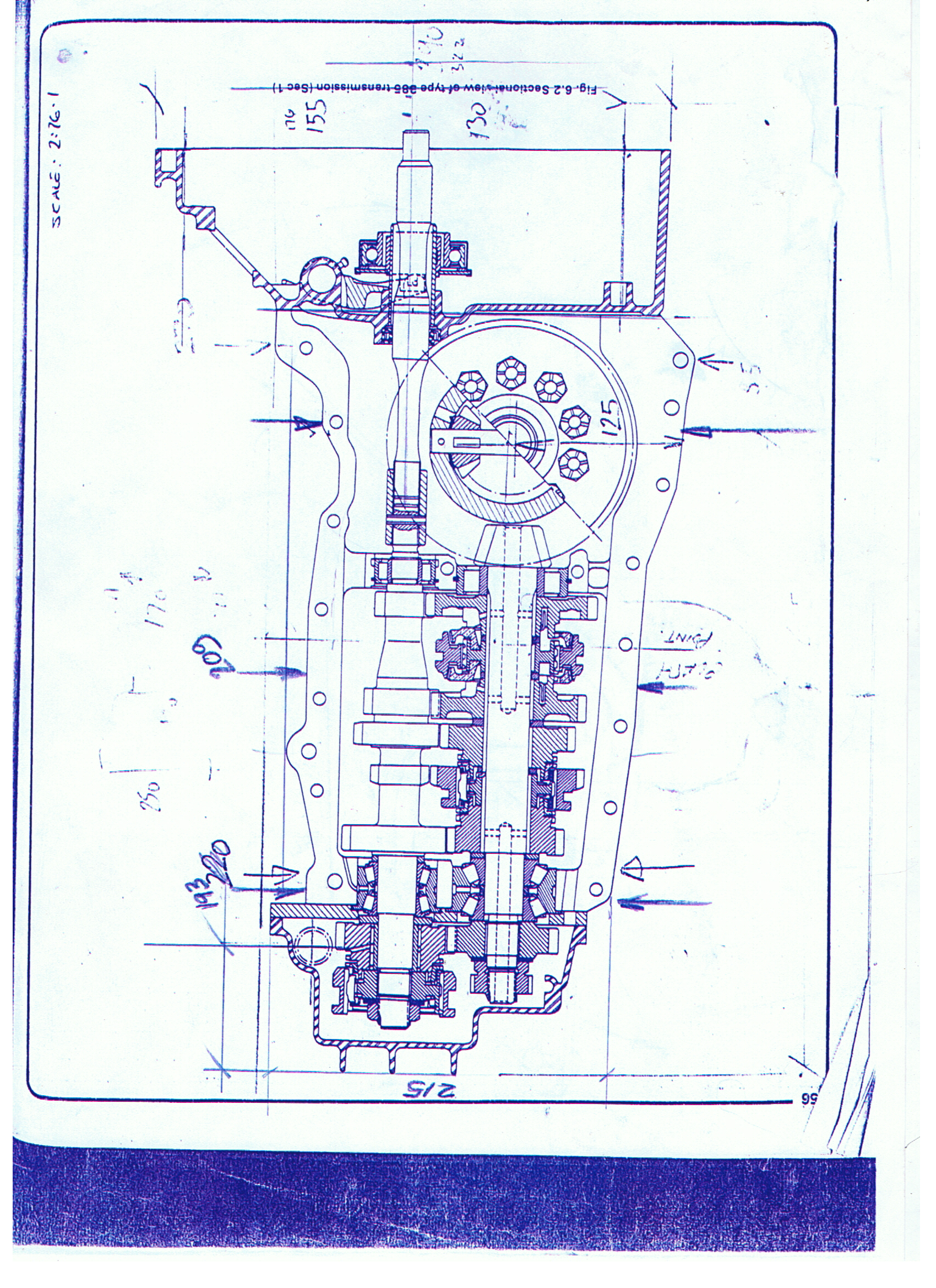

The past couple of months I have been looking at gearbox selection available to complete my OT (berlina) , Guy here I think likes the Porsche 901 series of boxes for the size,ratio's and how many have been used in the past ,also a Fiat 850 box turned upside down as Abarth themselves have done, In Australia we have a short supply of #901 gearboxes and even harder to find in good condidtion, as it is hard finding most parts that are readilly available in Europe!
I have a old (early 1990s) vw gearbox conversion from a previous Fiat twincam to 850 project done here, not happy with most of the conversion, yes it did work but with issues. This forum has been very good for infomation on my project "OT" but with many ways of doing the same job I have to find a way forward with parts easy to find and hopefully in reasonable condition, I have found this on another forum for Fiat group cars, this subaru gearbox shop will sell a reverse crown and pinion set for rear engine vehicles!
http://subarugears.com/
I don't have the knowledge on Subaru gearboxes for strength or ratios, but think they are 30 years younger with parts available here and do know how easy they are to find in any condition !
So far have found these gearboxes used on Fiat 850's - Skoda130, VW type3 (4speed), Porsche 911 early and late(#901) and now Subaru!
I look forward to your thoughts on subaru and any other gearboxes used!
Regards Rubino

Wow, this has been a long road to nowhere! I am back to the VW type-3 4pseed box for Ren and myself, mainly because Subaru has lots of types, ratio and torque strengths , non that will fit with the little effort of the VW for length, CV's etc! we have available to us in Australia adaptor plates, axels and a range of parts for the VW type, having driven a Lombardi scorpion with a Fiat 2ltr twincam in the tail and loved it, it has been in the car for a decade and reliable, take a look at the Cast Alloy adaptor we have with the flywheel on the dummy motor!

The renault gearboxes are not easy to find, Rubin, or is it that the use of an VW gearbox allready done by others so it is very usable?!
Looks good the adapter. It looks like the adapter I've got from PBS for my OT.
Rubino
Yes Fred, the VW gear is easy to find, not expensive and all been done before!
