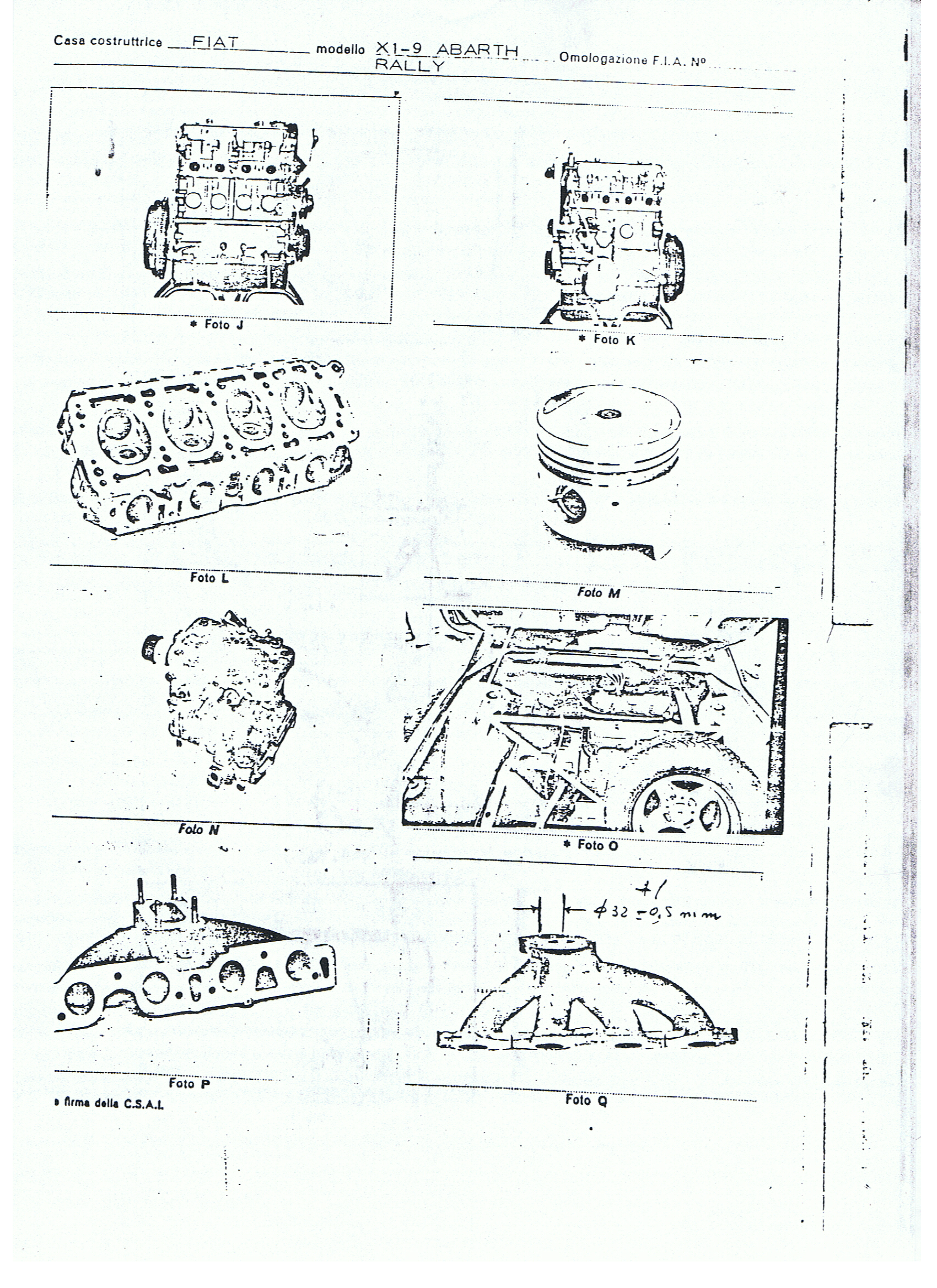

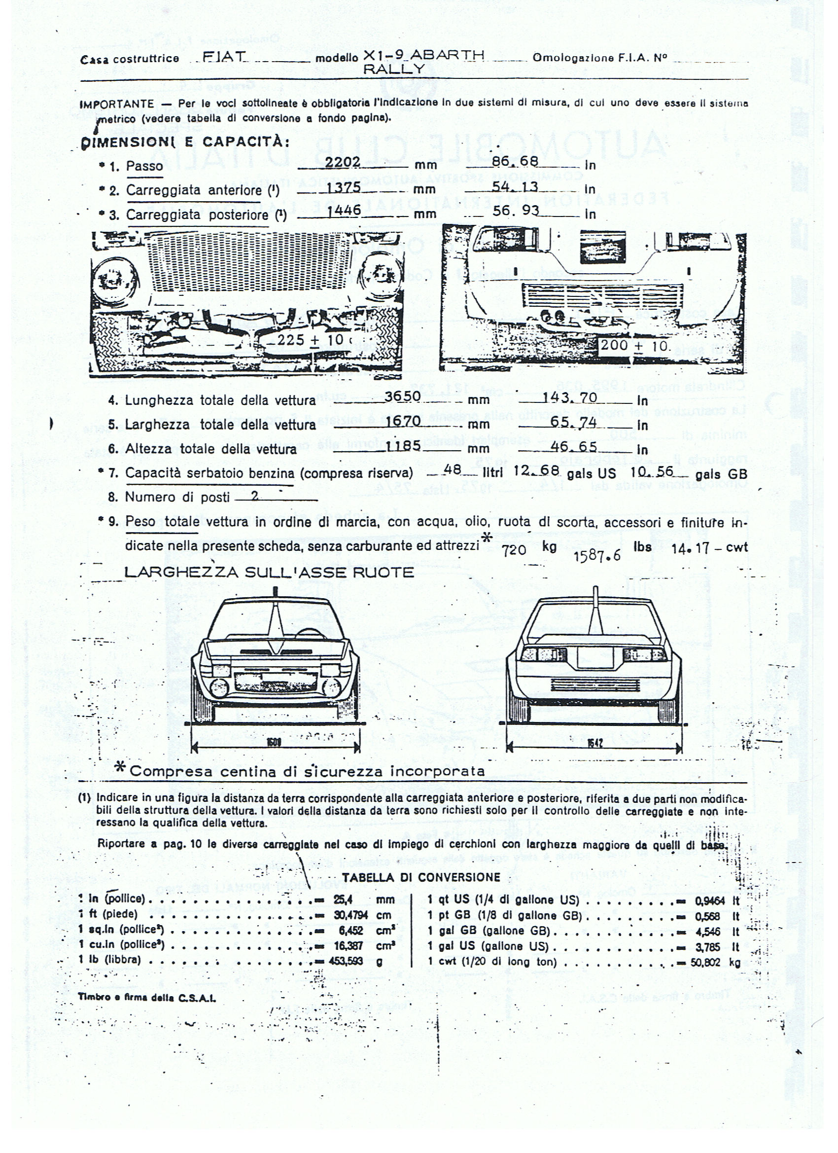

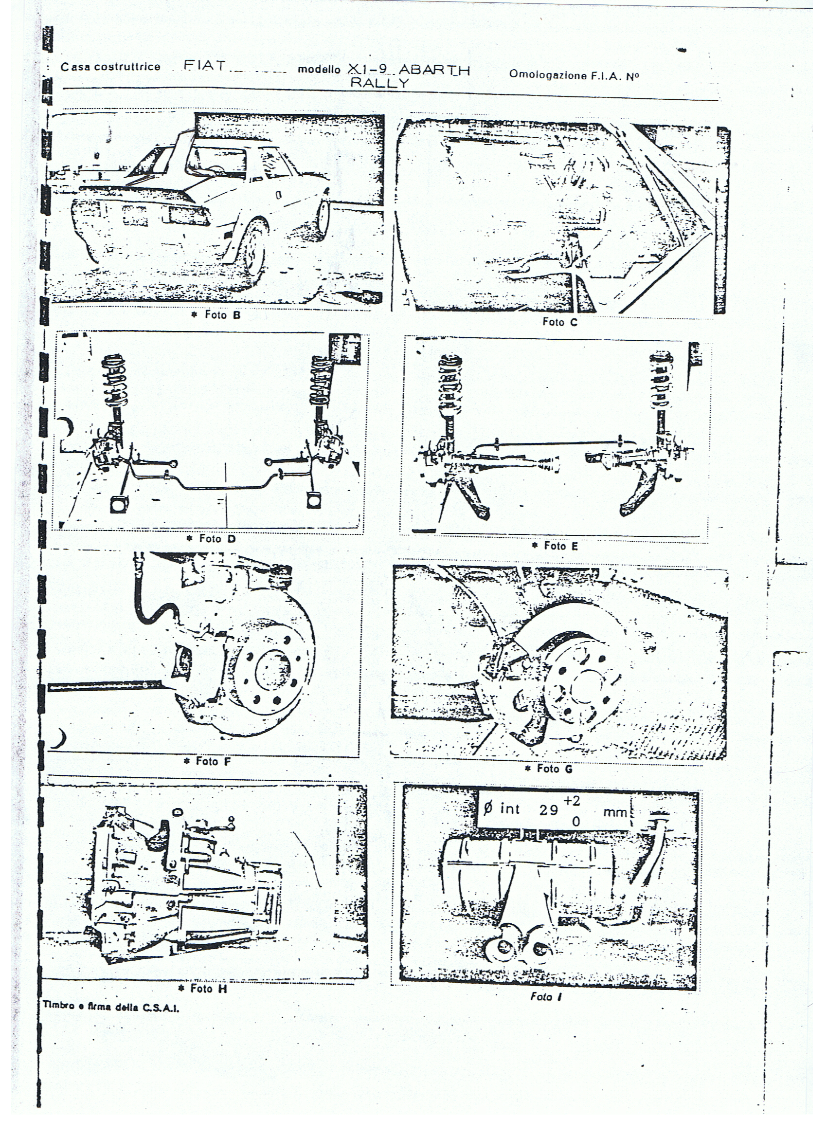

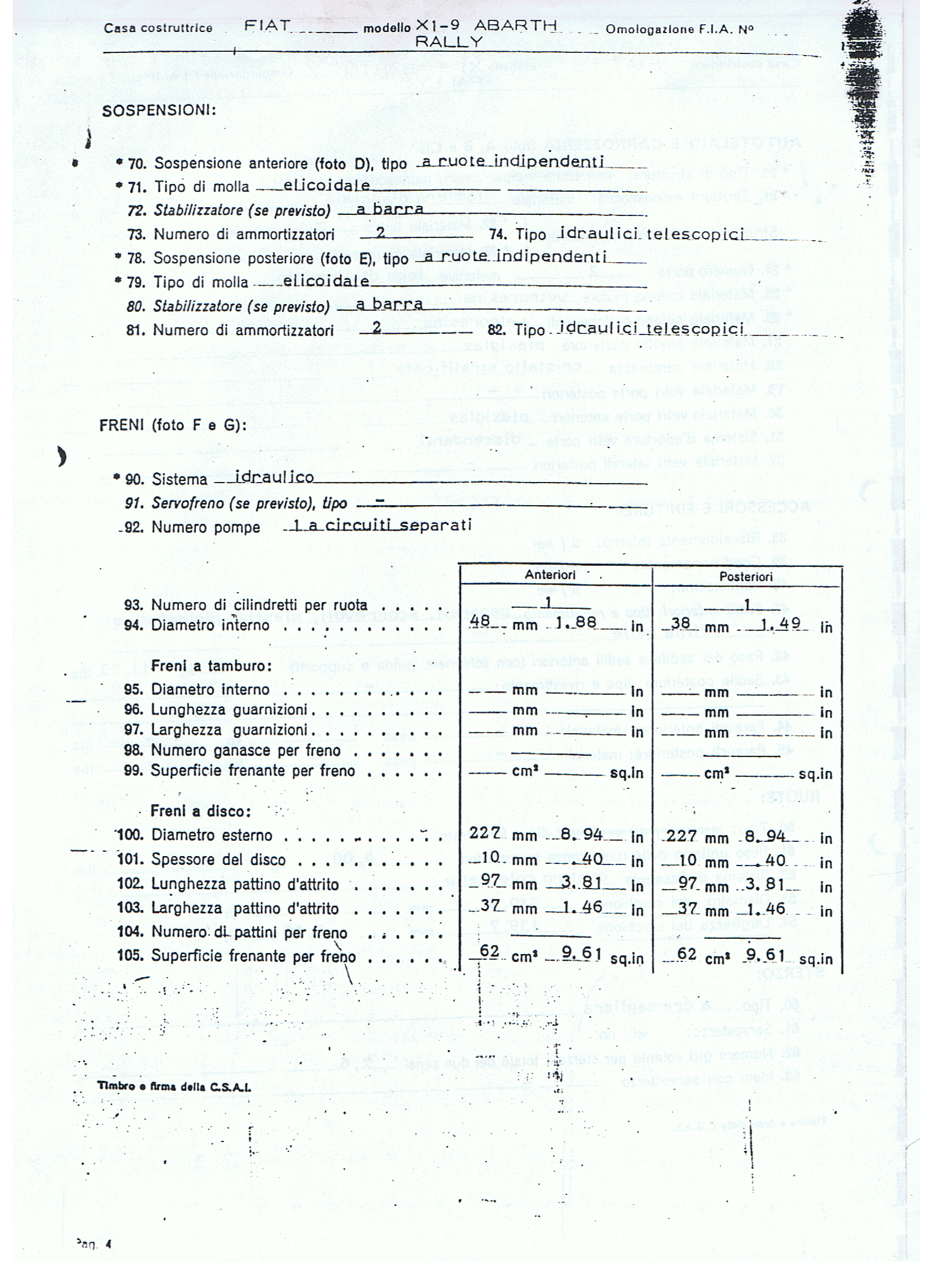

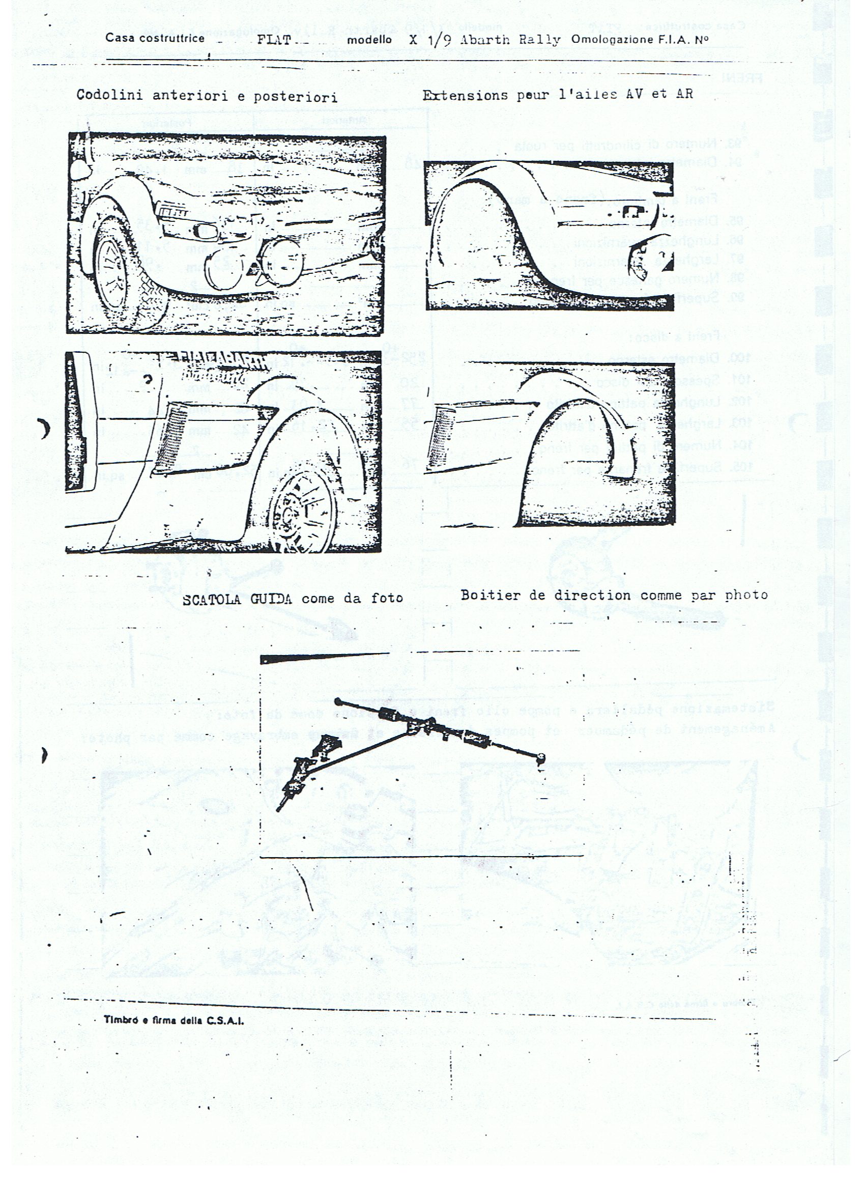

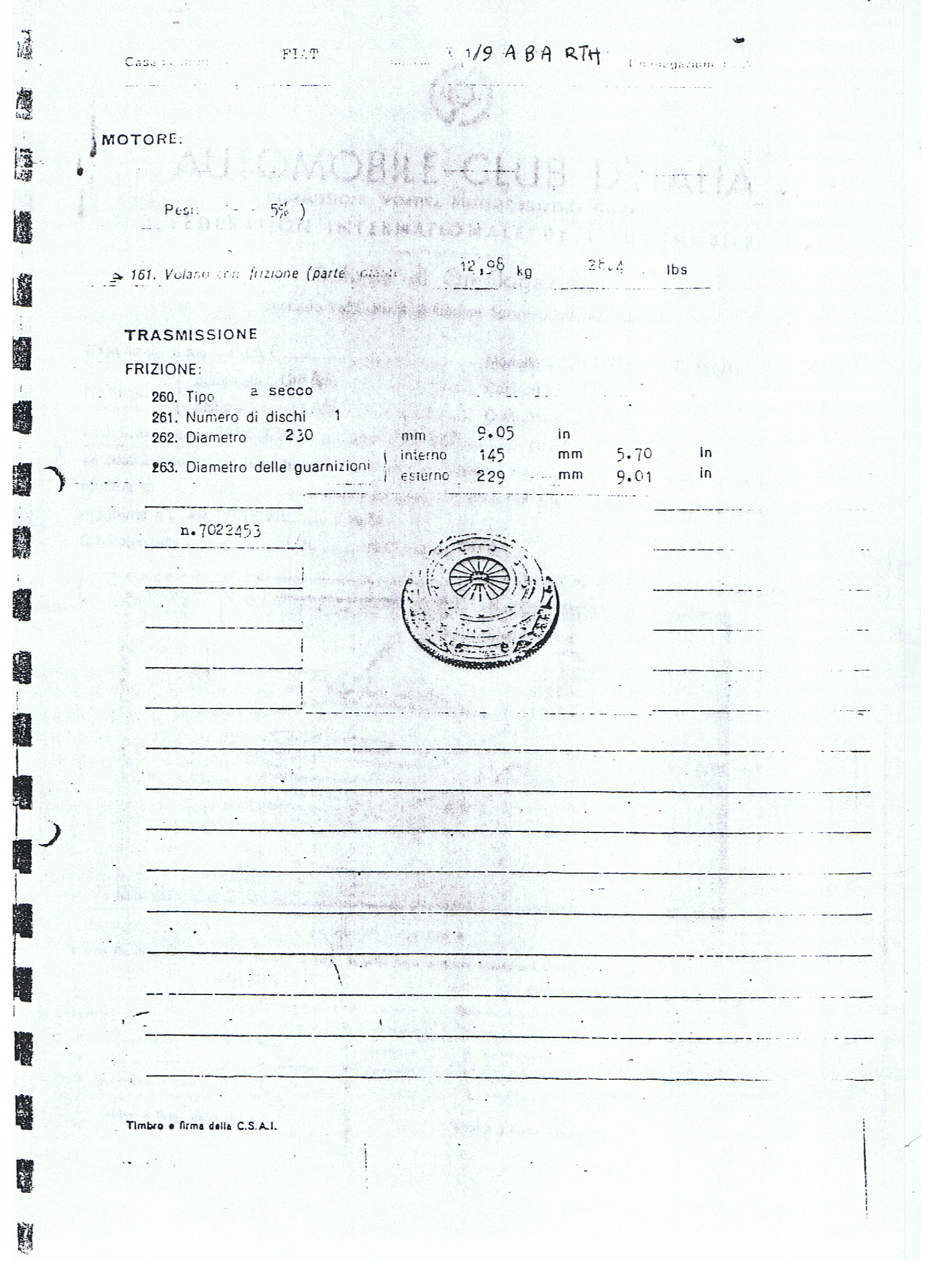

base is a 1500 X 1/9  but now  fitted  with a 131  16 V abarth  engine  and a Ritmo Abarth gearbox .AVO shocks  with small springs ,bigger brake and full rally equipment
Must I say that its  fast
Sure  8x13 & 7x13 cromodoro wheels to keep it on route .Our  you wish to  have the  7x15 Abarth wheels .Its  fits  also nice
Oilcooler,2 fuelpomps ,rallyseat like in Original car,rollbare   etc......
